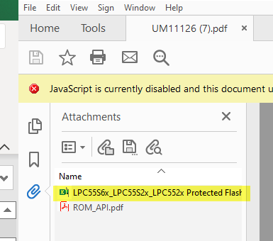

Hello @bwinter
There is a demo about disable SWD and ISP , you can refer to.
 About "bit definitions in the UM11126.pdf manual.", please see excel in attachment of UM.
