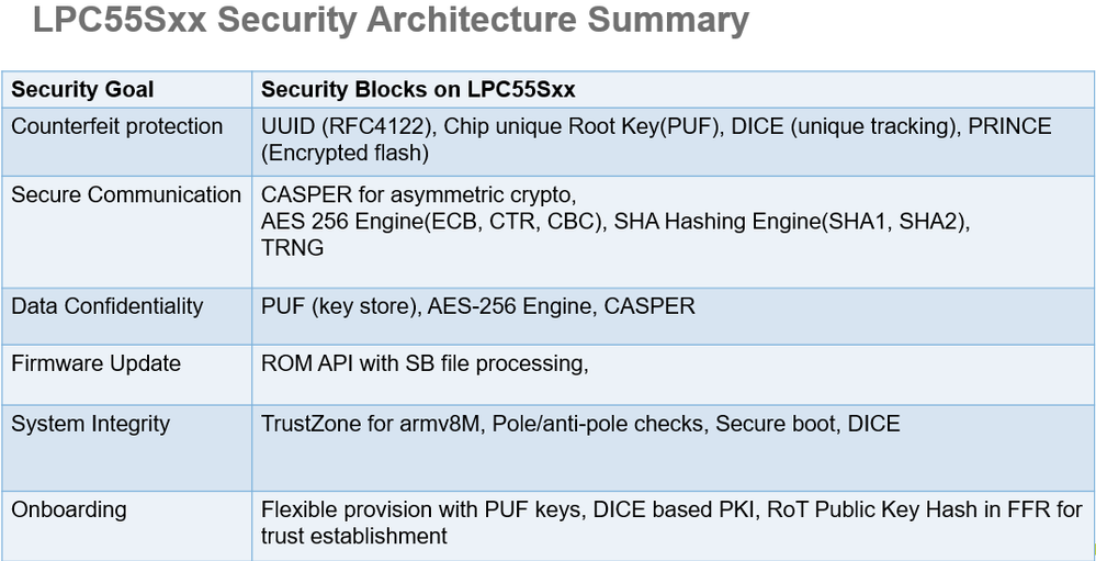

I was wondering if the new LPC55S6x mcu's include an ARM Cryptocell, like a 310, to perform the cryptography functions? Or is this implemented differently?

Hi Frank
LPC55S6x mcu doesn't include an Cryptocell. LPC55S security architecture summary is as below
