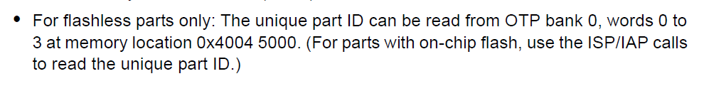

The user manual for the LPC18S37 (UM10430) list the feature on page 14:
Unique ID for each device.
But the Unique ID is never referenced in the entire manual. My question: does a Unique ID exist in ROM code of the LPC18S37 which can be used a serial number?

I found it at “5.7.13 Read device serial number”.
Thank you!

Q1) My question: does a Unique ID exist in ROM code of the LPC18S37 which can be used a serial number?
-- No, you can read the unique part ID by referring to Fig 1.
Fig 1
