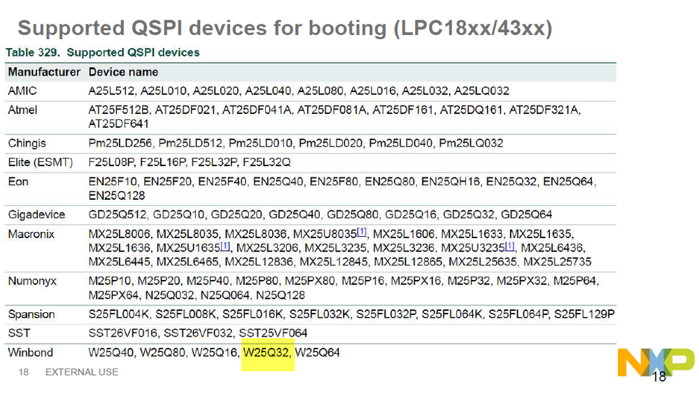

LPC1830 use S25FL032P0XMFI013 as a QSPI Boot Device.
If customer want to use W25Q32 to replace S25FL032P0XMFI013 for cost down, does W25Q32 is in support list of QSPI  Flash.
I see some 3 party LPC1830 EVB use W25Q32 as boot QSPI Flash Device.

Hi Li-Chin Wang,
  Please check this picture:
W25Q32 already in the supported list, so you can use it!
