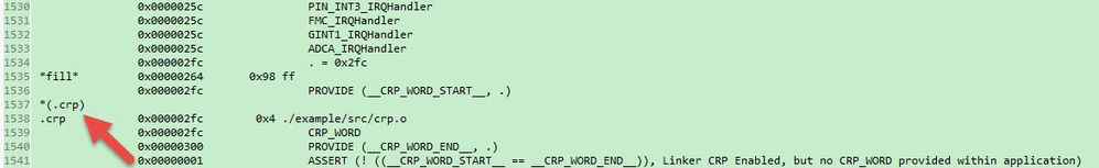

mattferrari
Hi Ping -
Is it not the case that in CRP1, Sector-0 is NOT supposed to be erased unless ALL sectors are being erased?  Isn't that the whole point of Sector-0, that when using CRP1, Sector-0 is protected and will persist unaltered unless ALL sectors are selected for erasure?  The intent of CRP1 is to allow partial field updates to Flash WITHOUT altering Sector-0.  So I should be able to download a couple sectors of new code WITHOUT affecting Sector-0, isn't that correct?
The User Manual (Rev 1.3, Section 27.4.2) states for CRP1:
- Copy RAM to flash command can not write to Sector 0.
- Erase command can erase Sector 0 only when all sectors are selected for erase.
So if I have established CRP1, then via the USB Bootloader I delete "firmware.bin" in Windows Explorer and copy in a new file containing only a few Sectors of new code, Sector-0 should remain as it was, unaltered and unaffected by the update.  It shouldn't be erased, but I am observing that in fact it IS getting erased.
This is what I'm still trying to make sense of.  Can you please explain this discrepancy?  Or if I am still misunderstanding things, please reconcile the statements from Section 27.4.2 and the fact that I am seeing Sector-0 get erased when only a few Sectors are being updated via the USB Bootloader.
The only possible explanation I can think of is that the action of deleting the "firmware.bin" file in Windows Explorer via the USB Bootloader actually has the effect of first deleting ALL the Sectors in Flash, then subsequently, the new file is written into Flash.  Is this what's happening?  But if that is so, then this would completely defeat the whole point of being able to do partial field updates to Flash using the USB Bootloader while preserving Sector-0, which is what I thought CRP1 was all about.  I'm starting to think that deleting "firmware.bin" via the USB Bootloader results in the deletion of all Sectors of Flash.  Is this correct?  It would be really helpful to get clarification on this...
Thanks Ping

mattferrari
Hi Ping, thank you for your reply.  Yes, I read this in the User Manual too.  The reason I've posted is that the description of how CRP1 SHOULD work is not what I'm seeing.  I have also read in some App Notes that CRP1 DOES erase all the flash before writing, so the information is inconsistent.  Here's what I'm seeing:
1) Program CRP for CRP1.
2) Power cycle the chip, enter the bootloader and observe: CRP1 ENABLD at the drive designation.
3) Delete "firmware.bin" and copy over new file which is only a couple sectors in size.
4) Reset chip and observe that instead of running the new code, it just re-enters Bootloader and displays: "CRP DISABLD"
This sequence of events demonstrates that Sector-0 (where CRP is stored at 0x2FC) was in fact overwritten when the "firmware.bin" file was deleted and the small ".bin" file was transferred.
Since not ALL sectors were being written, this shouldn't happen.  Sector-0 (and thus the CRP) shouldn't have been altered because CRP1 was in force.  But Sector-0 was obviously written as evidenced by the CRP change reported at the drive designator after reset.
So I am trying to figure out why I am seeing this.  Why deleting "firmware.bin" and copying in the new code leaves Sector-0 erased.
Can you explain why this would be happening?
Thanks.
12,751件の閲覧回数
jeremyzhou
Hi Matt Ferrari,
As I mentioned before, when the "firmware.bin" file was deleted and the small ".bin" file was transferred, it means the  "firmware.bin" file occupied area had been erased and the sector 0 in included in the area which is illustrated in the map file (Fig1).
Ping
