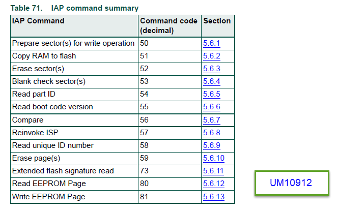

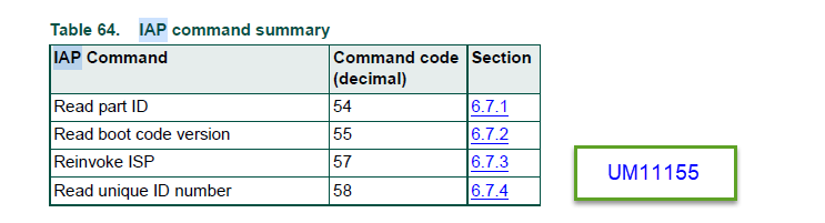

LPC540xx, unlike LPC546xx, doesn't integrate IAP prepare sectors for write operation and erase sector command.
Actually, According to LPC540xx UM, There are only 4 IAP commands valid.
If we check LPC546xx UM, more IAP commands are supported:
That's different.

I understood your mentioned "LPC54018M" as "LPC54018JxM", right?
LPC54018JxM has Internal Serial Flash but other LPC540xx doesn't have internal Flash.
So LPC54018JxM  has flash. But as LPC54018JxM flash is a internal serial flash, ( encapsulating a SPIFI flash inside the package), It's different with other on chip flash chips.  So I am with your angle of view to understand this issue.
