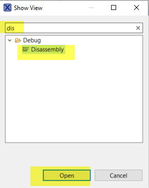

How do I select "Disassembly view" in MCU Expresso? Sometimes it pops up of its own accord, but I can't find out how to select it when I want it to appear.

Hello ianbenton,
You can open it from  Window -> Show View-> Other...-> Disassembly
as blow highlight in picture:
Hope it helps,
Alice
