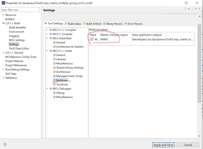

Hello -
I have a project that I'm working on under MCUXpresso v11.6.1. The project was initially created as a multicore project. I want to undo that and have the project configured just to run on core0. How can I do that? The documentation seems to be silent on this.
Is it possible to re-run the project configuration wizard to update the configuration of an existing project?

Regarding your requirement to remove the code for the core1 and just keep the code of core0, I think there are two methods, you can create a new project with just core0 and copy the code in the old project for just core0 and remove the code like MCMGR......... and the erpc.....
The second method is to unload the project for the core1 in MCUXPresso tools. For the project for core0, just  delete the the code like MCMGR......... and the erpc....., in the MultiCore menu, uncheck the slave box.
Hope it is helpful
