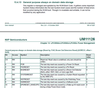

I'm using Deep Sleep and Deep Power-down in our application. In both the wakeup can be triggered by RTC alarm and two GPIOs (Deep Sleep: PINT, Deep Power-down: dedicated wakeup pins).
I need to use Deep Power-down to minimize the power consumption for most of the time (Power-down is not an option since it drives all pins low). The problem is that I also need to know which wakeup source I can blame after the wakeup. In Deep Power-down a wakeup causes a chip reset which means I cannot use RTC general purpose registers to store the wakeup source data (I assume there's no time for using ISR before the reset occurs).
Is there any way I could see the wakeup source after waking up from Deep Power-down?
I'm using LPC55S28.
Thanks.

We can check general purpose always on domain data storage. I extract it from UM11126.If this doesn't help, please contact me again.
This is General purpose always on domain data storage.
Remark: This register is managed and updated by the ROM boot and cannot be updated by any application.
Hope this helps,
Jun Zhang

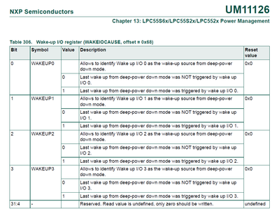

Thanks @ZhangJennie!
I was already using AOREG1 storage for logging purposes but the problem was that it didn't provide information about which I/O caused the wakeup (indeed it shows if it was caused by the RTC alarm or some wakeup pin). But after taking another look at the user manual, I found the WAKEIOCAUSE register which was the missing piece of the puzzle. Now it works perfectly!
