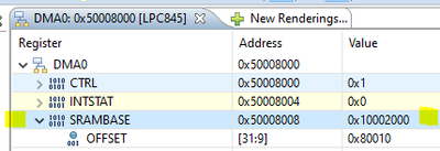

Probably , when you called the DMA_InstallDescriptorMemory() function , the address of the DMA descriptors was set in the  SRAMBASE . However the functions that received the DMA channel arguments where using the default address of s_dma_descriptor_table0, which is  placed on SRAM0 at 0x1000_0200
For example:
void DMA_SubmitChannelTransferParameter(
    dma_handle_t *handle, uint32_t xferCfg, void *srcStartAddr, void *dstStartAddr, void *nextDesc)
  dma_descriptor_t *descriptor = (dma_descriptor_t *)(&s_dma_descriptor_table[instance][handle->channel]);
    DMA_SetupDescriptor(descriptor, xferCfg, srcStartAddr, dstStartAddr, nextDesc);
Using the lpcxpresso845max dma_m2m_polling example I tried to  set the DMA descriptors into SRAM1
1 I created a new  memory region, according  to the  address of SRAM1 region. And then I specified the dma descriptor table to be placed in that  area.
#include  "cr_section_macros.h"
__DATA(descriptor_RAM ) dma_descriptor_t s_dma_descriptor_table0[(25)]   __attribute__((aligned((512)))); // ;
 2 After the DMA_init was done,  the SRAMBASE received the addres of the s_dma_descriptor_table0
3 FInally ,  I was able to run the example ,having the DMA descriptors placed into the SRAM1 area.
DMA memory to memory polling example begin.
Destination Buffer:
0	0	0	0
DMA memory to memory polling example finish.
Destination Buffer:
1	2	3	4
