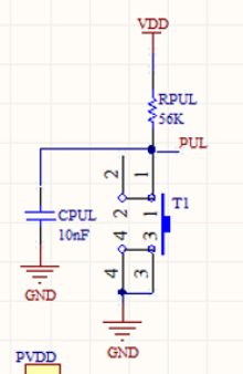

All the pins are without external connections, except wakeup pin, where I have an external pullup

Thank you Pavel. Which is the value of the pullup resistance you have in your wakeup pin?

Hello, I suggest removing the 56k RPUL. To test this issue
Pavel
6,408件の閲覧回数
eva
Hello, if I remove 56k pullup, current consumption increases up to 45 uA

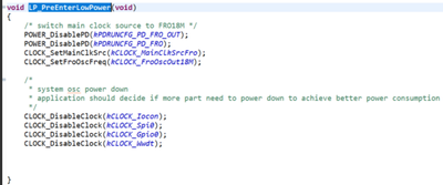

Hello, I have checked the code, suggest mode the below configuration to test this issue.
Do not disable the GPIO0 clock,
Because I don't have your board, it's limited for me to check this issue.
Pavel

I tried your suggestion, but the result is the same. I have the same current consumtion either I call LP_PreEnterLowPower function or not.
In Deep power down mode, power is shut off to entire chip except for the WAKEUP pins, digital peripherals are off, and PIOn_m pins are Floating, so that makes sense.
I could think that I have a problem in PCB, but if I enter power down mode instead of Deep power down mode, the current consumption goes to 6uA, that is the value in datasheet. So that makes me think that something is wrong in software.
I have measured current through pullup resistor, it is 0,4uA aprox, so it seems that 13uA consumption is internal.

I am using a custom board, all the pins are disconnected except the wake up pin (it has an external pullup resistor of 56komhs), and VDD is 3v3.
