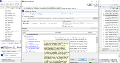

>>>>There is an example in SDK package:
Hope it can help you
