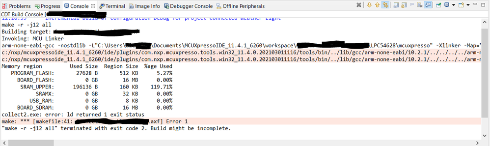

I currently struggle to get my application running and debug it on my LPCXpresso board 54628.
As you can see in the screenshots, after building my project with the default memory settings that the whole application does not fit into the first RAM location (SRAM_UPPER).

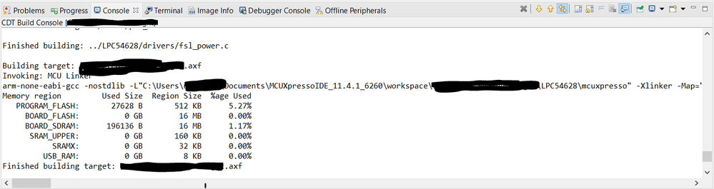

Therefore I wanted to increase the memory or change the memory order, for example I would use the BOARD-SRAM memory space which would have enough space for the application.

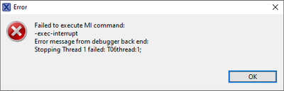

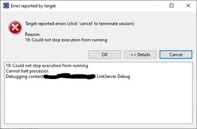

But when I build it and want to debug it, debugging with LinkServer does not work and I get the following error:
