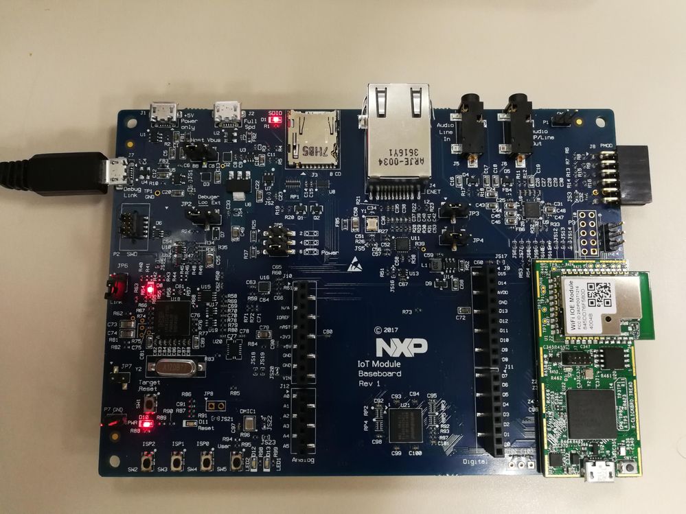

Hello Saranya,
Please be sure that you are connecting right the OM40007: LPC54018 IoT Module into the IoT Module base board, as shown in the following image.
Hope it helps!
Victor.
