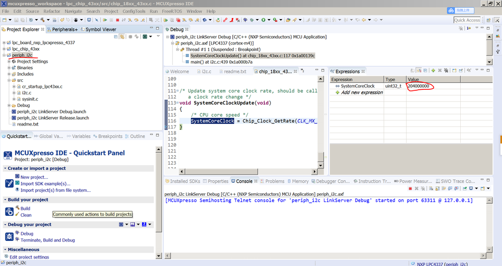

I am trying to get the I2C in an LPC4337 to work as a Slave receiver and having no luck. I have followed the recommended settings from the UM but still does not work. I have an LpcXpresso4337 and I am driving the I2C with an Aardvark I2C/SPI module from Total Phase. I am developing using MCUXpresso 10.2 using the LpcOpen 3.02 library. I have configured the pins in the SCU as I2C and turned on the input buffers. I have configured all 4 slave address registers to the same address and unused mask regs to zero. I am trying to run in interrupt mode. The interrupt is enabled in the NVIC. The CON has I2EN and AA set and all others cleared. When I send a packet I never get an interrupt and the status is stuck at F8. Is there any example code on how to do this?

Hi Dan,
I received some comments about this:
 I test periph_i2c example code in the lpcopen_3_02_lpcxpresso_xpresso4337 based LPCXpresso4337 board.
   Result: LPC4337 as slaver can success in transmission under 204MHz SystemCoreClock.
The terminal show as below:

Could you please try the example and see if you find the same issues?

There are two problems here with the M4 running at 204MHz. The first is the I2C state machine is not stable at this frequency and needs more time to settle. When changing from state 60 to state 80 it goes through state F8 before it gets to state 80. This can be captured by reading the states into an array. If you look at the code below you can see I captured the states in global array tmp[] so I could look at them after it crashes. You will see a for loop commented out at the beginning and the end. This will come in later. Transferring two bytes + address the states go as follows:
tmp[0] == 60
tmp[1] == F8
tmp[2] == 80
tmp[3] == F8
tmp[4] == 80
tmp[5] == F8
tmp[6] == A0
Ending in the Hard Fault Handler()
Uncommenting the for loops solves this problem, but you need one on enter from interrupt and you need one on exit back to interrupt. The F8 states go away and it runs normally.
tmp[0] == 60
tmp[1] == 80
tmp[2] == 80
tmp[3] == A0
Note there is a bug in the library in State 80 where it tests for: if (xfer->rxSz > 1). This must be changed to if (xfer->rxSz > 0) or you will never get your last byte.
