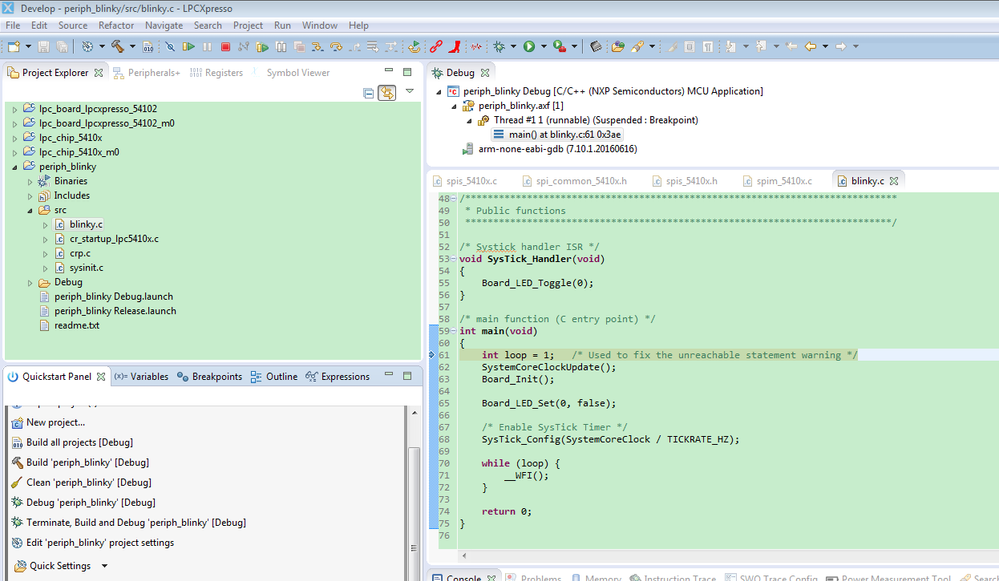

       I have LPCXpresso54102 LQFP64 Rev A (OM13077) board and installed IDE LPCXpresso_8.1.0_597 on windows 7 64 bit OS.
To start work with this LPC54102 , i have imported the below projects from archive for blinking the LEDS
        Imported projects :
                                 lpc_board_lpcxpresso_54102,
                                lpc_chip_5410x ,
                                periph_blinky
But i cannot start debug and it is showing errors as "No source available for "0x30002da"  and attached the image file also for reference. I cannot guess what type of error . please help me to proceed further

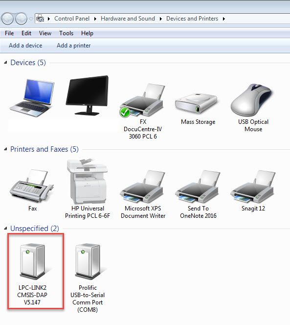

Hi Ratheesh T,
   1. Please check the device and printers, whether it is the CMSIS-DAP debugger after you connect the on board J6 interface to the PC.
2.open the LPXpresso IDE, and add the board, chip lib and bliky project.
  Build the lpc_board_lpcxpresso_54102 and lpc_chip_5410x at first, then build the periph_blinky project.
  Now, click debug button in the following picture:
click OK at last
4. you will enter the blinky project
Please follow my step, and try again.
Wish it helps you!
If you still have question, please let me know!
Kerry

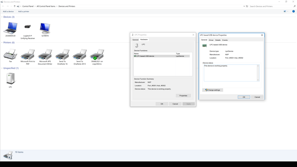

pedromartinezlo
I do have the same issue not only with periph_blinky but also with multicore_m4master_blinky project, which I'm trying to set up as explained in this tutorial.
I have followed your steps and I still get the same error: "No source available for "0x30002da", both for periph and multicore projects.
- I'm running LPXpresso 8.2.2 with the OM13077 Evaluation board, which is "recognized" by Windows 10 as shown in the image below.
- LCPopen package for LPCXpresso54102 is 3.03
- The emulator is found
- All debug sessions are terminated
- I've tried all USB ports in my laptop to J6
- JP1 is open where the Target SWD is connected to either the on-board Link2 debug probe
- JP5 is shunted to use the LPCXpresso IDE with Redlink protocol
- I have checked under my debug configuration that Build configuration is set to Debug
Thank you in advance for the help,
