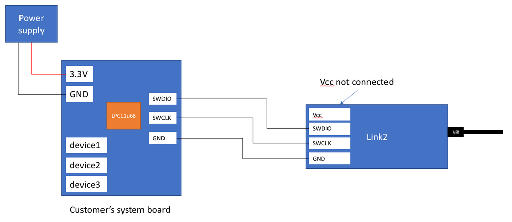

leechen
Thank for reply Jeremy.  Do you mean when customer's board has power supply itself, I need to leave JP2 open, with Link2 connected to customer's board with only SWCLK, SWDIO, and GND?

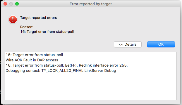

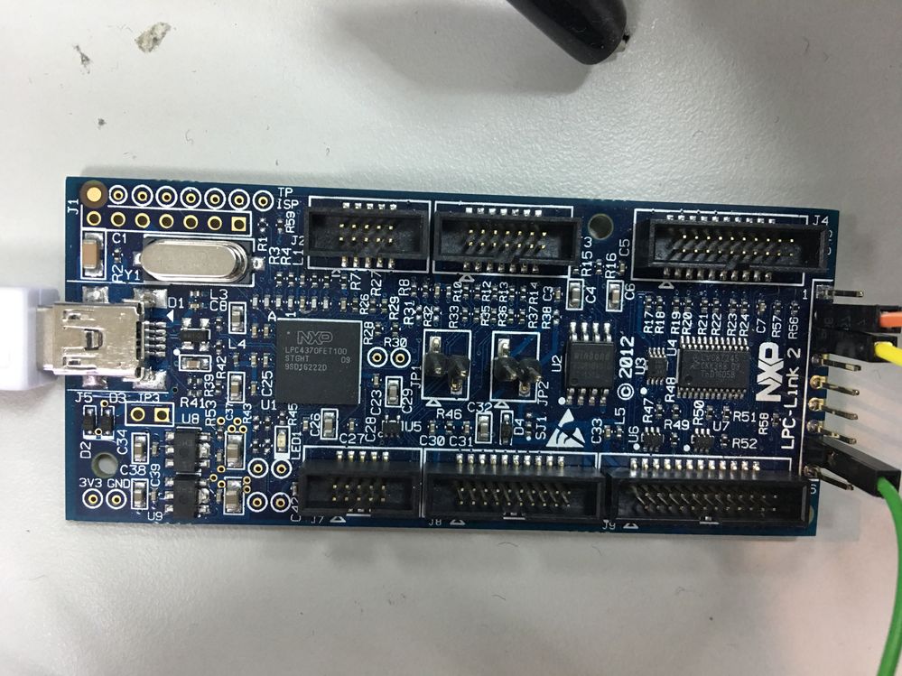

leechen
but I get this error when I have JP2 open. Picture as shown below.

jeremyzhou
Hi Lee Chen,
Thanks for your reply.
You should remove jumper of JP1 if you want to debug the target board with LPC-link2.

leechen
Yes I did have both JP1 and JP2 removed as shown on the picture above.

jeremyzhou
Hi Lee Chen,
Sorry, I made a typo error.
It should be "You shouldn't remove jumper of JP1 if you want to debug the target board with LPC-link2."

lpcxpresso_supp
If the customer is using a different supply, there's no reason for the LPC-Link2 to supply power. So, leave it unconnected.

leechen
I am having a problem that when it's 2.9V on customer's board, I can use Link2 to go into debug mode. However, after customer raised the voltage to 3.4V, I cannot go into debug mode. I don't understand why this is happening. Is there any way I can use oscilloscope to see what's causing the problem?
