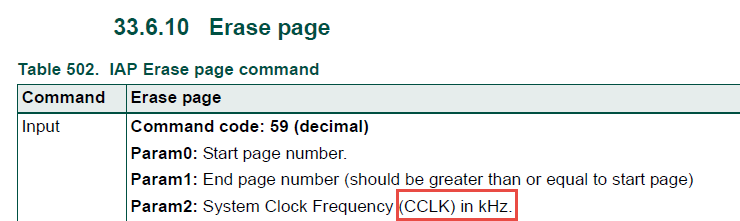

my device is lpc54102,system clock is 100M,FLASHTIM is 0x05,I use flash IAP like this :FLASHIAP_ErasePage(start_addr >> 8, end_addr >> 8, 24000000u);fast than FLASHIAP_ErasePage(start_addr >> 8, end_addr >> 8, SystemCoreClock); SystemCoreClock is 100M;Why is this?

Hi liu js1,
the opportunity to serve you.
I don't think the format of Param2 is correct, please try again.

The clock will be converted to the correct format,this is the function code is:
status_t FLASHIAP_ErasePage(uint32_t startPage, uint32_t endPage, uint32_t systemCoreClock)
uint32_t command[5], result[4];
command[0] = kIapCmd_FLASHIAP_ErasePage;
command[1] = startPage;
command[2] = endPage;
command[3] = systemCoreClock / HZ_TO_KHZ_DIV;
iap_entry(command, result);
return translate_iap_status(result[0]);
HZ_TO_KHZ_DIV is 1000
