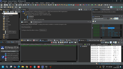

I am using ARM LPC54606 Microcontroller, Using Mcu xpresso IDE, MCU-Link Debugger, i am able to flash the code, the Breakpoint does not it the main function, the compiler shows "Breaks at address 0x3008704" with no debug information available. or outside of the program code

Please test as follows:
  1. Create a new MCUXpresso IDE workspace.
  2. Create a new project.
  3. Erase all the flash, then download and debug.
If there is still an issue, please record a video showing all the steps.
