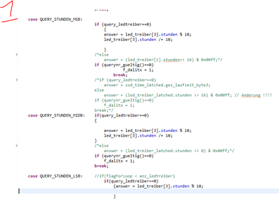

Hi, I'm currently sending hours to Dali Master by breaking it down to 1 byte and sending LSB, MIDB, and MSB. I've attached the picture of my code. the stunden(hour) value is 324. But my logic doesn't work.
I used two logics
Picture mark with 1 is for 3 or higher digits and it doesn't work. When I used the commented part for two digit it works fine but not for 3 digits and above.
Can somebody help me out that what could be the problem in my code? How can I separate the 324 to MSB=3, MIDB=2, LSB=4

Regarding your question about "what could be the problem in your code", as I can see, you are probably missing to divide by 100 in the MSB, so, "how can you separate the 324 to MSB=3, MIDB=2, LSB=4" , we would like to suggest you this code snippet that you might use in your code:
void stunden (uint32_t hour, uint8_t bit);
typedef struct{
uint8_t msb;
uint8_t midb;
uint8_t lsb;
}stunden_t;
stunden_t g_stunden;
switch (bit)
case QUERY_STUNDEN_MSB:
hour /= 100;
g_stunden.msb = hour;
break;
case QUERY_STUNDEN_MIDB:
hour /= 10;
g_stunden.midb = hour % 10;
break;
case QUERY_STUNDEN_LSB:
g_stunden.lsb = hour % 10;
break;
default:
break;
return;
And then you can use this function like this:
 main.c :
stunden(324, QUERY_STUNDEN_LSB);
stunden(324, QUERY_STUNDEN_MIDB);
stunden(324, QUERY_STUNDEN_MSB);
So this function can return the value that you want for 3 digits, and for 3+ digits you may add to the function the other cases dividing the hour by 1000, 10,000, and so on.
