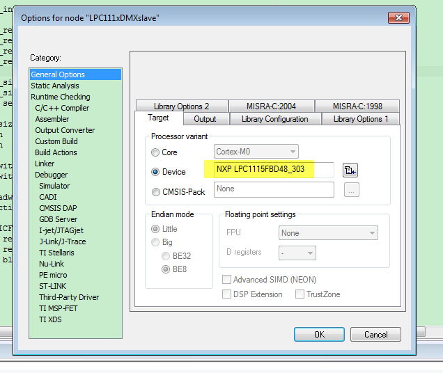

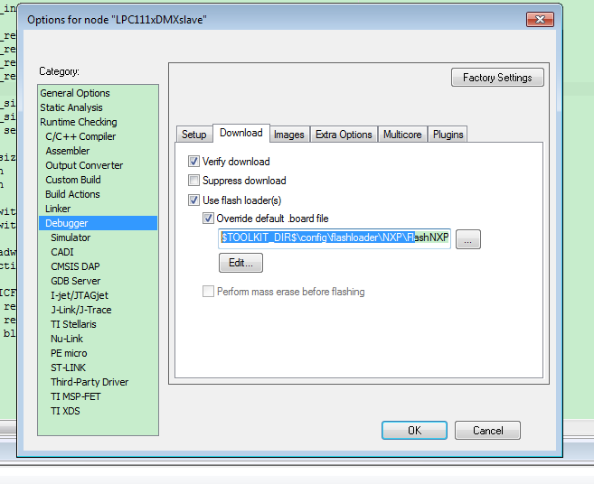

    What the project you have tested? LPC111xDMXslave.eww in folder: C:\nxp\lighting\backup\DMX512_RDM_SDK_v1.0\LPC111xSlave?
   I also simply test it on my LPC1115 board, and debug it. Because I don't have the application's board, then I simply test it with the lpcxpress 1115 board, this board have the on board CMSIS DAP debugger.
  This is my debug result:
Then my on board P0.7 can be pull low, my red led is on.
So, I think you'd better to find a debugger to test it on your side, otherwise, it is not easy to find the problem on your own designed board.
If you are using the LPC1112, you also need to modify the .icf file, change the ROM end address, because LPC1112 just have 16KB, but LPC1114 have 48KB.
The project chip you also need to change it to your own chip, this is my example:
You can find a debugger and try it again.

I tried on both complilers - IAR and LPCXpresso. You can see in the screenshot below, in the IAR environment, the project is loaded and compiled, with no errors except for 5 warnings.
The warnings are:
Warning[25]: Label 'NMI_Handler' is defined pubweak in a section implicitly declared root D:\DMX512_RDM_SDK_v1.0\LPC111xSlave\src\startup_armcm0.s 118
Warning[25]: Label 'HardFault_Handler' is defined pubweak in a section implicitly declared root D:\DMX512_RDM_SDK_v1.0\LPC111xSlave\src\startup_armcm0.s 123
Warning[25]: Label 'SVC_Handler' is defined pubweak in a section implicitly declared root D:\DMX512_RDM_SDK_v1.0\LPC111xSlave\src\startup_armcm0.s 128
Warning[25]: Label 'PendSV_Handler' is defined pubweak in a section implicitly declared root D:\DMX512_RDM_SDK_v1.0\LPC111xSlave\src\startup_armcm0.s 133
Warning[25]: Label 'Default_Handler' is defined pubweak in a section implicitly declared root D:\DMX512_RDM_SDK_v1.0\LPC111xSlave\src\startup_armcm0.s 138
And also, I changed the target to my LPC now:
As a simple debugging procedure, I just added some lines to the code, to turn off and on the LEDs (not the traffic lights) and also a simple command to dim. With a multimeter and oscilloscope , I don´t see the PWM output.
That´s why I think it is not a problem with the firmware but in the way it is flashed or with the ROM addresses. Sorry, I´m new to LPC micros... I haven´t modified the .icf file, should it be done manually ?
