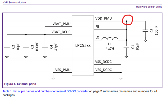

I'd like to know what the expected output voltage of the internal DCDC converter of the LPC55xx is, see red circled node in the screenshot below (copied from AN12325, page 2)?
That is, what voltage is at VDD_PMU typically? I know that according to the datasheet, VDD_PMU maximum voltage is 1.26 V. So the output node of the DCDC converter will be below this voltage. But what should I expect? 1.0 V? I'm designing my own custom board using LPC5526 and I'd like to verify that it is working properly.

Hello Nadia,
There is an application note about LPC55xx DCDC, you can have a look:
https://www.nxp.com.cn/docs/en/application-note/AN12325.pdf
