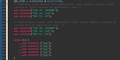

I am a student Embedded systems and I am trying to make a small custom bootloader work on my LPC1758. What I am trying to do is flash my bootloader between 0x0000 and 0x8000. My next step (for testing purposes) is to flash my application after 0x8000. However, when I let the program run, It will crash when it jumps to the application address. (see image below.)

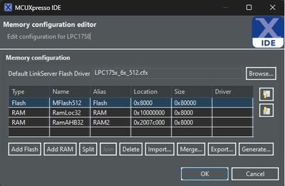

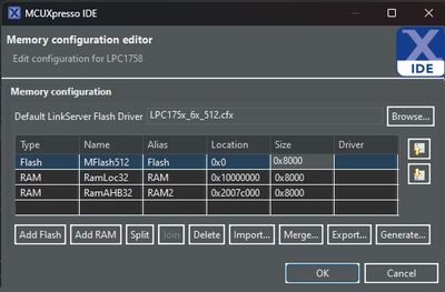

I had the feeling that I had to change my project memory settings. After some research and trials, I could't work it out. (first one is bootloader, second one is application)
Does anyone have an idea how I should set this up correctly?

Update: This is what I get back.

Hi @Alice_Yang , Thanks for your reply! I would like to know more about the memory mapping. Should the application have a seperate size too? What I am trying is the following:
  1. flash bootloader.
  2. flash my application second with second MCUXpresso instance.
  3. let the bootloader code run through the jumping process.
This works good. But when I try to flash my application with my custom software, the bootloader gives me UNDEFINED INSTRUCTION. I checked the .hex file and this is written correctly into the memory.

The flash size of application should 0x80000 - 0x8000, because the total size of flash is 0x80000 (512k),
bootloader uses 0x8000.

I have seperated the Flash size for bootloader and application.

I still get this error at jump while debugging bootloader :

1) From your screenshot, it application size still 0x80000:
2) RAM needn't.
