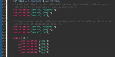

I am a student Embedded systems and I am trying to make a small custom bootloader work on my LPC1758. What I am trying to do is flash my bootloader between 0x0000 and 0x8000. My next step (for testing purposes) is to flash my application after 0x8000. However, when I let the program run, It will crash when it jumps to the application address. (see image below.)

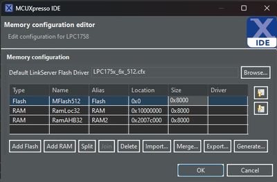

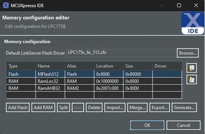

I had the feeling that I had to change my project memory settings. After some research and trials, I could't work it out. (first one is bootloader, second one is application)

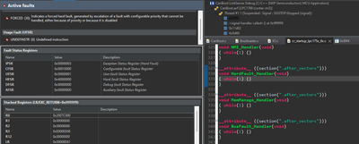

Update: This is what I get back.

4) There is USB secondary bootloader for lpc1700, you can refer to the jump code :

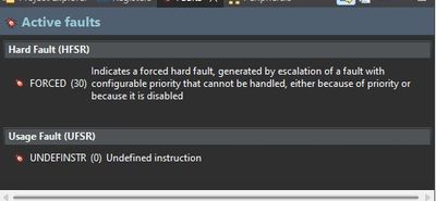

This works good. But when I try to flash my application with my custom software, the bootloader gives me UNDEFINED INSTRUCTION. I checked the .hex file and this is written correctly into the memory.

Hello @BerkantCiftci2001
The flash size of application should 0x80000 - 0x8000, because the total size of flash is 0x80000 (512k),
bootloader uses 0x8000.
Alice

I still get this error at jump while debugging bootloader :

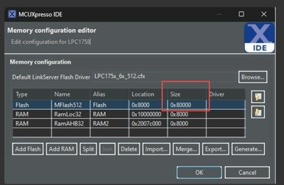

1) From your screenshot, it application size still 0x80000:
2) RAM needn't.
