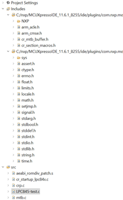

In this way I am able to create a project with the following structure
but I do not see the LPC845.h file that let me access to the register with the CMSIS definitions. Where can I find it?
Let's say that I currently have some fuctions  like this one below made for the LPC8xx microcontroller
void spi0_init(void){
LPC_SYSCON->SYSAHBCLKCTRL|=(1<<11); /* enable clock to SPI0 */
LPC_SYSCON->PRESETCTRL&=~(1<<0);
LPC_SYSCON->PRESETCTRL|=(1<<0); /* reset SPIO0 */
LPC_SPI0->DIV=12;
LPC_SPI0->CFG=CFG_MASTER | CFG_ENABLE; /* enable SPI0 as master */
My goal it is to create a project to have all these functions running on the LPC845 instead of the LPC82x therefore I need the LPC845.h file to rewrite everything with the correct syntax.

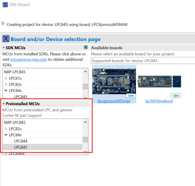

Hello @topspin
When create new project, you don't have to choose SDK, as below:
