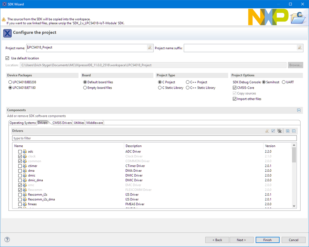

How can I create a clean new empty project (not an example, and not using a demo board) , which includes specific drivers and all the needed files for these drivers ?
When I create new project using MCUXpresso IDE, I only have the source with the main.c but how do I include/create all the drivers and other necessary files to these drivers ? (fsl_gpio.h, fsl.i2c.h, libs ...)
( I am using LPC5411X MCU)

Use the 'New project...' item:
Then select your CPU (I assume you have loaded the SDK from Welcome | MCUXpresso SDK Builder ) and then you can select/add your drivers as you want:
I hope this helps,
Erich
