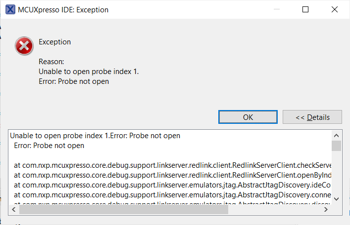

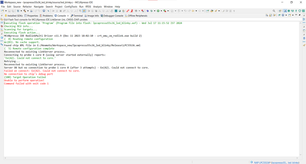

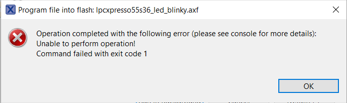

I am currently working on LPC55s36-EVK board (https://www.nxp.com/part/LPC5536-EVK#/ )and it was working properly for last 6 months. But while debugging a project the no connection to the chips debug port error appeared as shown in the figures attached below.
I tried to connect the board with other PC and it works correctly and also I have another LPC55s36-EVK board and it works with my PC.
I have deleted the .launch file and tried to rebuild again but it didn't work. I changed my workspace and reinstalled my IDE also that also didn't help. I have also updated the driver in my device manager which also didn't work.

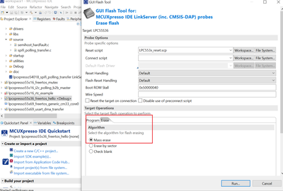

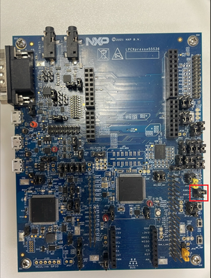

1. You can erase the flash in IAR mode.
you need to short the jumper J43 3-4.
And then erase the flash.
2. Cancel the J43 jumper and program the code.
