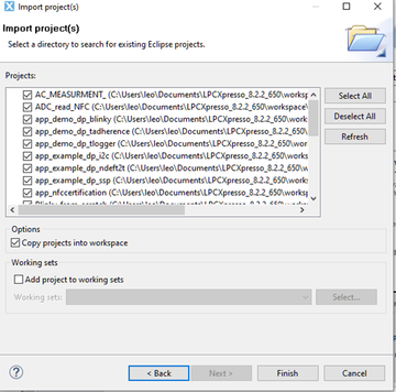

I want to copy a workspace to my onedrive folder, for backup.
Existing workspace: C:\Users\leo\Documents\LPCXpresso_8.2.2_650\workspace
Copying to (works): C:\Users\leo\Documents\trial_working\workspace
Copyting to (doens't work): C:\Users\leo\OneDrive\CODE\notworking\workspace
I am doing the following  steps:
1. I am creating a new workspace:
  • file--> switchworksplace-->other --> C:\Users\leo\Documents\trial_working\workspace
2. Import projects I want to copy:
  • import projects--> C:\Users\leo\Documents\LPCXpresso_8.2.2_650\workspace
  • selecting copy all projects into workspace .
Import projectsImport projects

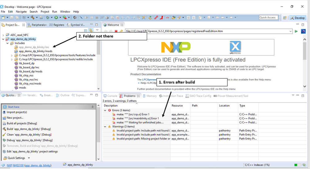

However if i repeat the process by creating a new workspace in  C:\Users\leo\OneDrive\CODE\notworking\workspace i get the following errors on blinky build:
Errors with ONEDRIVE workspaceErrors with ONEDRIVE workspace
I have checked that the paths are present:
Paths includedPaths included

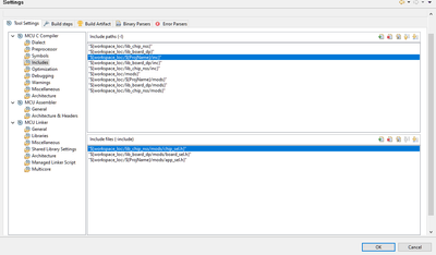

Here are the paths, with nothing unusual in the .cproject
The .cproject paths:
<listOptionValue builtIn="false" value="&quot;${workspace_loc:/lib_chip_nss}&quot;"/>
<listOptionValue builtIn="false" value="&quot;${workspace_loc:/lib_board_dp}&quot;"/>
<listOptionValue builtIn="false" value="&quot;${workspace_loc:/${ProjName}/inc}&quot;"/>
<listOptionValue builtIn="false" value="&quot;${workspace_loc:/lib_board_dp/inc}&quot;"/>
<listOptionValue builtIn="false" value="&quot;${workspace_loc:/lib_chip_nss/inc}&quot;"/>
<listOptionValue builtIn="false" value="&quot;${workspace_loc:/mods}&quot;"/>
<listOptionValue builtIn="false" value="&quot;${workspace_loc:/${ProjName}/mods}&quot;"/>
<listOptionValue builtIn="false" value="&quot;${workspace_loc:/lib_board_dp/mods}&quot;"/>
<listOptionValue builtIn="false" value="&quot;${workspace_loc:/lib_chip_nss/mods}&quot;"/>
and
<listOptionValue builtIn="false" value="&quot;${workspace_loc:/lib_chip_nss/mods/chip_sel.h}&quot;"/>
<listOptionValue builtIn="false" value="&quot;${workspace_loc:/lib_board_dp/mods/board_sel.h}&quot;"/>
<listOptionValue builtIn="false" value="&quot;${workspace_loc:/${ProjName}/mods/app_sel.h}&quot;"/>

OK, I see what has happened.
The "includes" that you are worried about - that just reflects your project settings. In your project settings, "Include paths" you have a reference to "${workspace_loc:/${ProjName}/inc}" which is a non-existent directory. So, just delete the reference and this will clean up the "includes" in your project.
