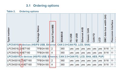

I am reviewing the LPC54018J2MET180 microcontroller and noticed that the datasheet and system architecture mention 2MB or 4MB on-chip memory, but this detail is not included in the user manual.
Please confirm the exact on-chip memory size for this part number. Also, is there any special or updated user manual available for this product?

Hello @Balaji_KG
The ​LPC54018J2MET180 is equipped with a 2 MB flash memory, while the ​LPC54018J4MET180 features a 4 MB flash memory.
The flash memory chip used in these devices is manufactured by Winbond, with the part number ​W25Q32JV-DTR.

Hello @Alice_Yang ,
Thanks for the update. Do you have a user manual that includes on-chip memory details? We need it for software analysis.
