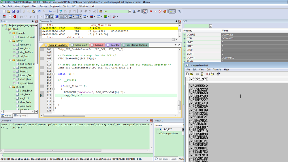

kerryzhou
Hi Remco Poelstra,
    I share a LPC824 SCT capture code with you.
    You can find it from the attachment.
   This code has been test on my side, the captured data is changing.
   Please check my attached project, this is the test result on my side:
Wish it helps you!
