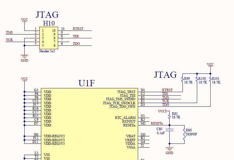

We cannot program or even erase the LPC4088 micro on our custom board. The board is based on the Embedded Artists LPC4088 QuickStart Board. Based on this schematic excerpt, what might we have done wrong?
We did already try connecting a jumper wire from the RESETn node to the RTRST node.

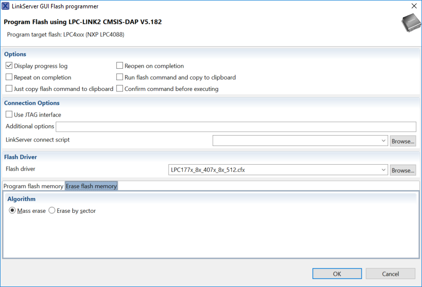

We're using an LPC-Link 2 to attempt the erase. As pictured below, we're using the Flash Programming GUI from the latest version of MCUXpresso IDE (v10.0.2 [Build 411] [2017-07-11]). We've tried both "Mass erase" and "Erase by sector" options; and we've tried with the "Use JTAG interface" option checked and unchecked. We get errors as shown below.
We are able to program and erase the LPC4088QSB with the same debugger (LPC-Link 2) and method (flash programming GUI), using the 20-pin ribbon cable, so I'm confident the problem lies either in the connection between the debugger and the board, or on the target board itself.

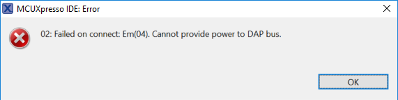

Output / error details:
Ns: MCUXpresso RedlinkMulti Driver v10.0 (Jun 22 2017 23:31:55 - crt_emu_cm_redlink.exe build 272)
Pc: ( 0) Reading remote configuration
Wc(03). No cache support.
Pc: ( 5) Remote configuration complete
Nc: Reconnected to existing redlink server (PID 4294967295)
Nc: Connecting to probe 2 core 0 (server PID unknown) gave 'OK'
Nc: Probe Firmware: LPC-LINK2 CMSIS-DAP V5.182 (NXP Semiconductors)
Nc: Serial Number: I3FUF1CU
Nc: VID:PID: 1FC9:0090
Nc: USB Path: \\?\hid#vid_1fc9&pid_0090&mi_00#7&19365f6e&0&0000#{4d1e55b2-f16f-11cf-88cb-001111000030}
Nc: connection to debug bus (DpID 0x2BA01477 AP Index[0]: 0xFFFFFFFF) <unknown wire type> failed - 'Em(04). Cannot provide power to DAP bus.'
Nc: connection failed - Em(04). Cannot provide power to DAP bus... Retrying
Ed:02: Failed on connect: Em(04). Cannot provide power to DAP bus.
Et: Probe(0): Connected&Reset. Was: NotConnected. DpID: 00000000. CpuID: 00000000. Info: <None>
Nc: Last stub error 0: OK
Nc: Last sticky error: 0x0 AIndex: 0
Nc: No debug bus (MemAp) selected
Nc: DAP Speed test unexecuted or failed
Nc: Debug protocol: SWD. RTCK: Disabled. Vector catch: Disabled.
Pc: (100) Target Connection Failed
Nc: error closing down debug session - Em(02). MEM-AP is not selected.

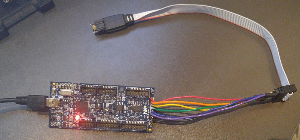

LPC-Link 2 with harness (target board not shown):

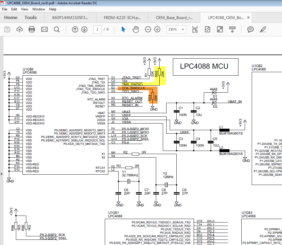

Hi Brendan McDonnell,

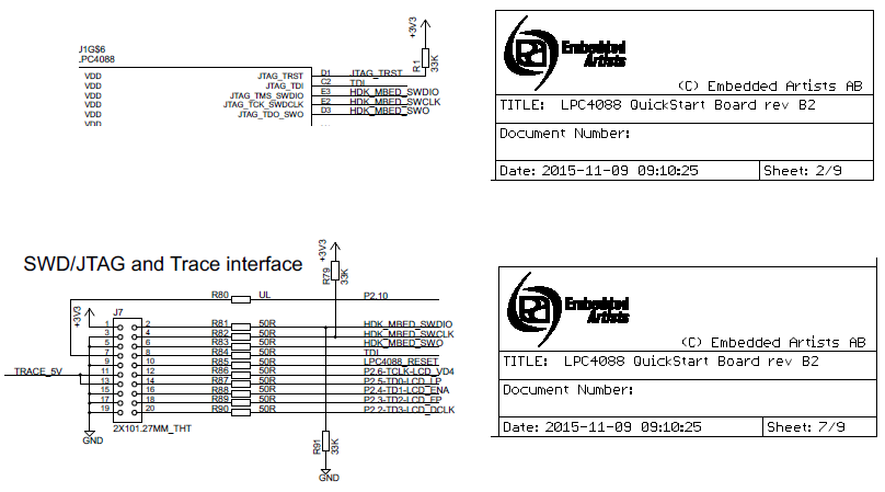

   I find there has some errors on your table:
EA LPC4088 board, JTAG_TMS/SWDIO is pull up, JTAG_TCK/SWDCLK is pull down.
 Please check the EA LPC4088 schematic:
I think you still can refer to the EA lpc4088 board, then configure the LPC-LINK2 to JLINK, use JLINK command, to check, whether it can find the core or not?

bmcdonnell_ionx
It's not an error. I'm talking about the EA LPC4088QSB, not the LPC4088 OEM board.
EDIT: In fact, the OEM board is represented on the next line in the table.
We did. Results described above.

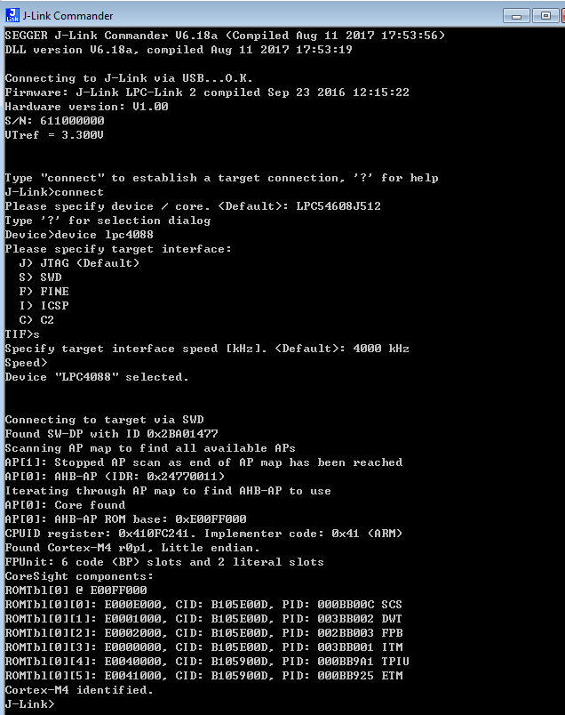

Please use the SWD mode, and the JLINK command test it again, with:
1. SWD_CLK pullup, SWD_DAT pull down
     Test it with SWD mode.
2. SWD_CLK pull down, SWD_DAT pull up
Then send the picture like this:
I need to check it again.

   1. I found your schematic have some problems, especially the JTAG interface, the pull up pins is not correct, please refer to this picture:
TMS, TDI, TRST, need the external pull-up resistor.
But, TCK, TDO need the pull down, not the pull up resistor.

SEGGER J-Link Commander V6.16b (Compiled Jun 9 2017 18:04:04)
DLL version V6.16b, compiled Jun 9 2017 18:03:30
Connecting to J-Link via USB...O.K.
Firmware: J-Link LPC-Link 2 compiled Sep 23 2016 12:15:22
Hardware version: V1.00
S/N: [redacted]
VTref = 3.300V
Type "connect" to establish a target connection, '?' for help
J-Link>connect
Please specify device / core. <Default>: LPC4088
Type '?' for selection dialog
Device>?
Please specify target interface:
J) JTAG (Default)
S) SWD
TIF>
Device position in JTAG chain (IRPre,DRPre) <Default>: -1,-1 => Auto-detect
JTAGConf>
Specify target interface speed [kHz]. <Default>: 4000 kHz
Speed>
Device "LPC4088" selected.
Connecting to target via JTAG
TotalIRLen = 4, IRPrint = 0x01
JTAG chain detection found 1 devices:
#0 Id: 0x4BA00477, IRLen: 04, CoreSight JTAG-DP
Scanning APs, stopping at first AHB-AP found.
****** Error: Could not find AHB-AP to communicate with Cortex-M core.
Cannot connect to target.
J-Link>

   1. EA board pullup or pull down question.
   Actually, EA board also have the pull up or pull down resistor, this is on the OEM_Base_board.
  JTAG or SWD interface is the typical circuit, all the MCU are using this design. So, both your own board or the EA board should add the according external pull-up or pull-down resistor.

If yes, please try to shorten your JTAG wire, I check your connection picture between the LPC_LINK2 and your LPC board, the wire is too long, it will cause the signal not stable.
Kerry

I may have found our issue. We don't have a pull-up on the ISP pin. I'll report back later.
Here is the relevant excerpt from Design Considerations for Debug:
  • ISP
    • Most NXP MCU's have an ISP pin which (when pulled low) can be used to cause the MCU to enter a bootloader on reset.
    • For example on LPC17xx this is P2.10 and on LPC11xx and LPC13xx it is P0.1.
    • Always ensure that you have a 10K to 100K Ohm pull up resistor on the ISP pin, otherwise you are unlikely to be able to make a successful debug connection.
    • NOTE : LPC-Link2 (in both standalone form and as built in to the LPCXpresso V2 / V3 boards) has the ability to force an ISP reset via pin 7 of the Cortex 10-pin 0.05" JTAG/SWD Connector. For more details see the FAQ "ISP Reset over debug".
Perhaps the OEM_Base_Board is different, but that's not the example we're using.

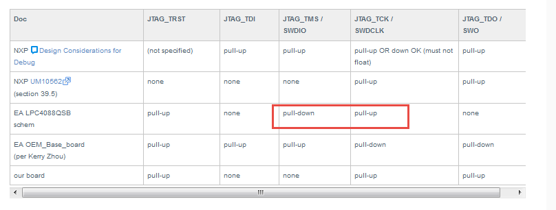

There appears to be a variety of options, as summarized in the table below, but there are some odd contradictions. (Note that the user manual (UM10562) says that there are some internal pull-up resistors.)
What is going on with TMS/SWDIO and TDO/SWO? How can pull-up, pull-down, or nothing all be valid options?
DocJTAG_TRSTJTAG_TDI
JTAG_TMS /
SWDIO
JTAG_TCK /
SWDCLK
JTAG_TDO /
SWO
NXP Design Considerations for Debug(not specified)pull-uppull-uppull-up OR down OK (must not float)pull-up
NXP UM10562
(section 39.5)
nonenonenonepull-uppull-up
EA LPC4088QSB
schem
pull-upnonepull-downpull-upnone
EA OEM_Base_board
(per Kerry Zhou)
pull-uppull-uppull-uppull-downpull-down
our board
pull-upnonenonepull-uppull-up
What I meant was that I was able to connect a couple of times on one board, and then never again on any of our boards. Odd.
We tried a shorter connection, but it didn't help.
