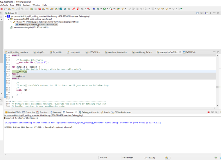

I tried to debug the code on one of our new prototype board, but I get struck in ResetISR()
I get this screen when I enter into debug section,

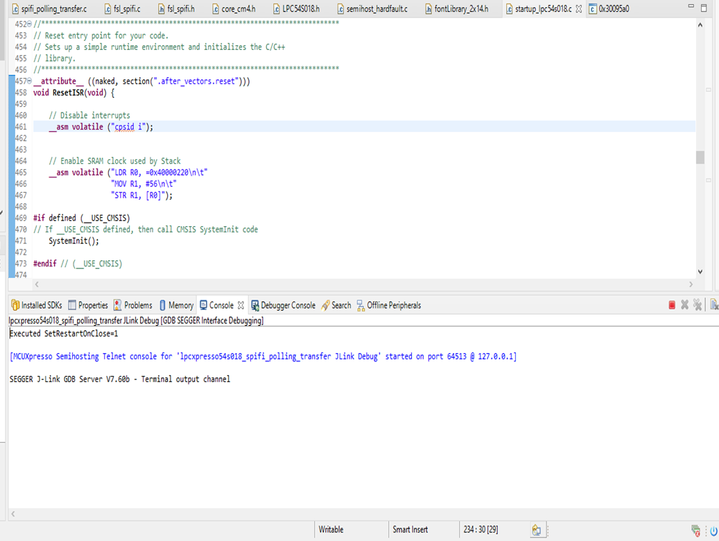

When I hit pause I get struck here,
I think something is not right with the BootROM.
Not sure what's going on, any help is appreciated.

xiangjun_rong
I do not think the phenomenon is related is BOOT ROM.
I suppose that your hardware has issue, which force the LPC54s016 to reset constantly.
pls check the power supply pins, spifi flash, clock...

NVazquez
I tried to write a small code with initialization, and I was able to program the board and also debug the code. Can we eliminate that there might be something wrong with the hardware?
