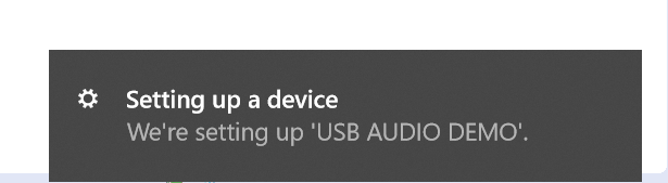

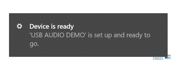

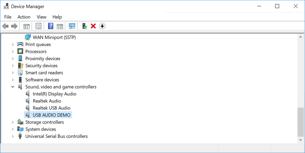

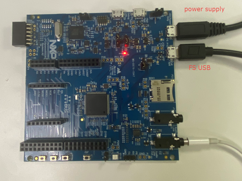

ZhangJennie
I tested the default demo code lpcxpresso55s69_dev_audio_speaker_bm with MCUXpresso v11.1.1. there is no issue.
after download the code. restart,  USB AUDIO DEMO can be recognized by windows as below
Jun Zhang
