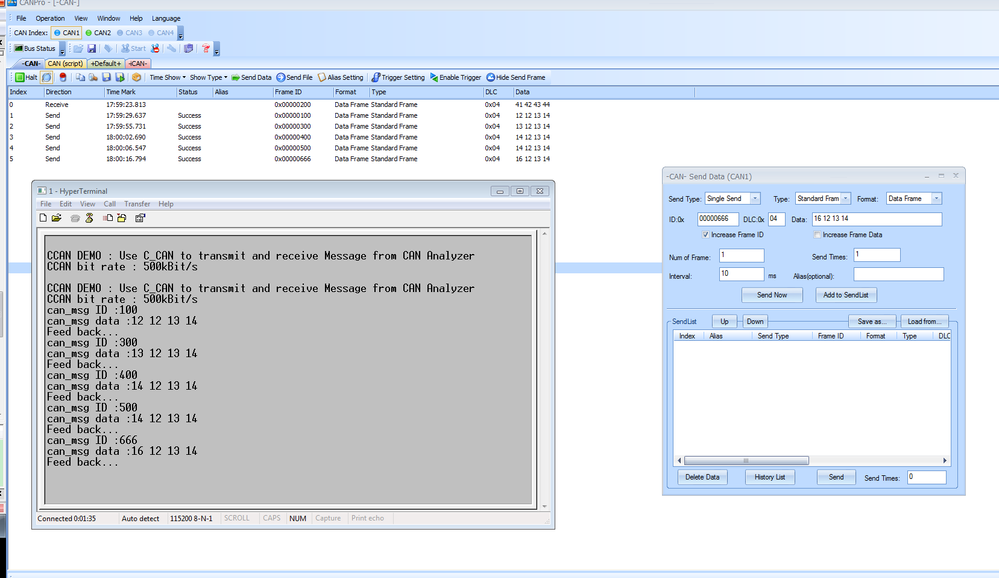

You can configure the can in the test mode, and enable the basic mode.
   Please modify the code like this:

After modify like the above code, I can receive all the IDs.
The test result is:
Wish it helps you!
