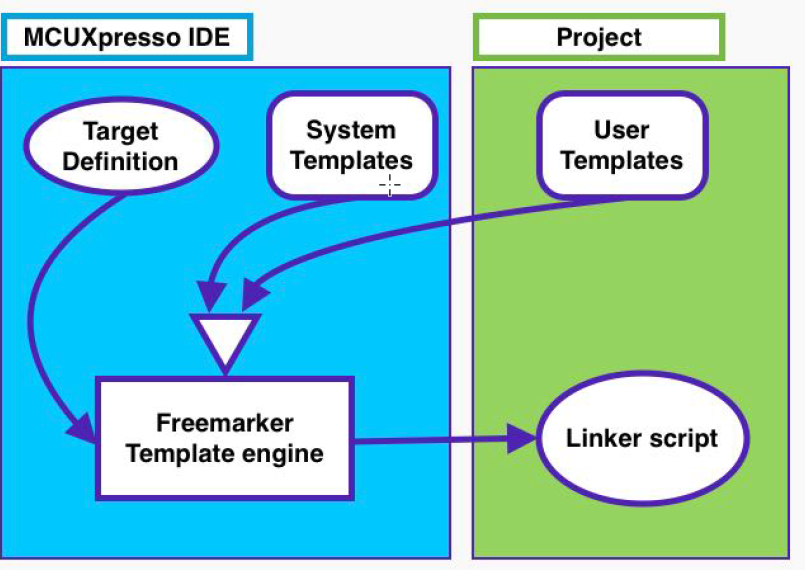

The LPC18S37 has two flash banks A and B. Usually flash bank A is used for downloading and booting. As I understand the user manual, both flash banks cannot not be used simultaneously, but code which is stored in bank B can be called from code in bank A.
Now I come to my question: does MCUXpresso IDE support distributed code in both flash banks? Or must I define my own jump table in bank B to reach function from bank A?
Thanks in advance

Hi Sol,
Thank you for the explanation. With the ability to modify the generation of linker scripts brings a great flexibility. A lot of the files *.ldt in folder …\ide\Wizards\linker are used to prepare the linker setup. Is there a small example how to include an own ldt file? Let say I write my own “flash2.ldt” where the linker statements for the Flash B are defined.
I would define a custom section for code for flash bank B:
void foo() __attribute__((section(".text_flashB")));
 void foo() {}
The file “flash2.ldt” generate the linker statements to include “.text_flashB” code content into section of flash bank B. I ask myself, how the ldt-file is loaded (automatically?) and where do I find examples of FreeMarker code snippets used by MCUxpresso?
I could imagine that this is a normal use-case for professional LPC18xx projects where the entire flash memory must be used. Do you know about such example?
I know, my question is a little bit ambitious and brings you into your maximum load limit. Sorry for that!
Anyhow, thank you for the help and useful answers so far!

You do not need to modify the linker script in anyway to add code to a specific section. The standard script will do this.
read chapter 17 of the user manual.
https://www.nxp.com/docs/en/user-guide/MCUXpresso_IDE_User_Guide.pdf
Especially 17.8 and 17.11.

Please let me know if the following information helps,
17.12 FreeMarker Linker Script Templates
By default, MCUXpresso IDE projects use a managed linker script mechanism which
automatically generates a linker script file without user intervention – allowing the project code
and data to be laid out in memory based on the IDE’s knowledge of the memory layout of the
target MCU.
However sometimes the linker script generated in this way may not provide exactly the memory
layout required. MCUXpresso IDE therefore provides a highly flexible and powerful linker script
template mechanism to allow the user to change the content of the linker script generated by
the managed linker script mechanism
17.12.1 Basics
FreeMarker is a template engine: a generic tool to generate text output (HTML web pages, emails,
configuration files, source code, etc.) based on templates and changing data. Built into
MCUXpresso IDE are a set of templates that are processed by the FreeMarker template engine
to create the linker script. Templates are written in the FreeMarker Template Language (FTL),
which is a simple, specialized language, not a full-blown programming language like PHP. Full
documentation for FreeMarker can be found at http://freemarker.org/docs/index.html .
MCUXpresso IDE automatically invokes FreeMarker, passing it a data model that describes
the memory layout of the target together with a ‘root’ template that is processed to create the
linker script. This root template, #includes further ‘component’ templates. This structure allows
a linker script to be broken down into various components, and allows a user to provide their
own templates for a component, instead of having to (re-)write the whole template. For example,
component templates are provided for text, data and bss sections, allowing the user to provide a
different implementations as necessary, but leaving the other parts of the linker script untouched.

The macros provided in the “cr_section_macros.h” header file provide some ability to control the
placement of specific functions or rodata items into the second (or even third) bank of Flash.
However the use of FreeMarker linkers script templates allow this to be done in a much more
powerful and flexible way.
One typical use case for this is a project which stores its main code and data in internal Flash,
but additional rodata (for example graphics data for displaying on an LCD) in the external SPIFI
Flash.
For instance, consider an example project where such rodata is all contained in a set of specific
files, which we therefore want to place into the external Flash device. One very simple way to do
this is to place such source files into a separate source folder within your project. You can then
supply linker script templates to place the code and rodata from these files into the appropriate
Flash.
For example, for a project using the LPC4337 with two internal Flash banks, plus external SPIFI
Flash, if the source folder used for this purpose were called ‘spifidata’, then placing the following
files into a linkscripts directory within your project would have the desired effect:
text.ldt
<#if memory.alias=="Flash3">
*spifidata/*(.text*)
</#if>
*(.text_${memory.alias}*) /* for compatibility with previous releases */
*(.text_${memory.name}*) /* for compatibility with previous releases */
*(.text.$${memory.alias}*)
*(.text.$${memory.name}*)
rodata.ldt
*spifidata/*(.rodata*)
</#if>
*(rodata.$${memory.alias}*)
*(rodata.$${memory.name}*)
Note: the check of the memory.alias being Flash3 is to prevent the code/rodata items from ending
up in the BankB Flash bank (which is Flash2 by default).
