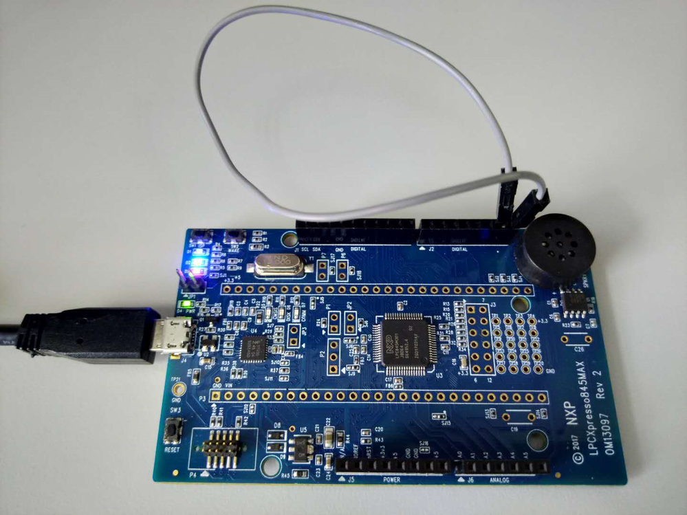

I'm using keil IDE and testing the sample code  of Ctimer_pwm[LPC845 MCU], using OM13097 development board,
and as read in the README.txt before compiling the code, given as " OUT_PORT.OUT_BIT connected to IN_PORT (defined in Ctimer_PWM.h)"
"The output pin is connected externally to another pin, IN_PORT, which is assigned to Capture 0 via the switch matrix.
- The CTIMER is configured for external count mode, incrementing on both edges of Capture 0."
Kindly suggest how to test the sample code of Ctimer output.,since on the above mentioned port pins i'm not
getting the output PWM.
Thank you

jeremyzhou
Thanks for your reply.
In the WKT_IRQHandler() function, it would toggle the P0_25 to output the PWM, connecting the P0_25 to P0_24, then CTimer's counter can increase on the rising or falling edges on the P0_24 (T0_CAP0).
So to test the CTimer_PWM demo, you should connect the P0_25 to P0_24 as the below figure shows.
TIC

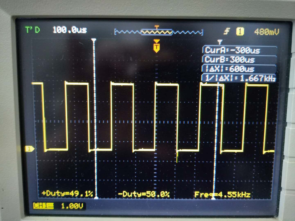

jeremyzhou
It's a bit weird, the CTimer_PWM demo runs well on the LPC845 MAX (Rev 2) board on my site.
Whether you have other LPC845 MAX boards and this phenomenon also happen when testing other boards.
Meanwhile, I'd like to suggest you download the most updated version of the example code bundle for testing.
