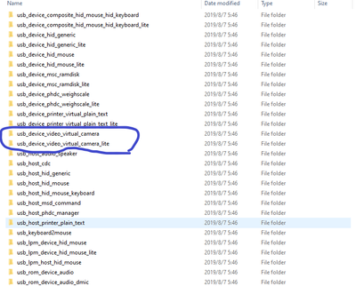

The LPC43xx has ROM usb api, but it does not support UVC(USB Video Class), it includes MSC, DFU, HID and CDC classes.
USB core function table
USB MSC function table
USB DFU function table
USB HID function table
USB CDC function table
I suppose you can consider the LPC546xx, for example LPC54628, the USB stack includes "usb_device_video_virtual_camera" and "usb_device_video_virtual_camera_lite"
You can download SDK from the link:
https://www.nxp.com/design/software/development-software/mcuxpresso-software-and-tools-/mcuxpresso-s....
Hope it can help you
XiangJun Rong
