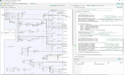

I am using LPC54607J512 with external oscillator equal to 12MHz.

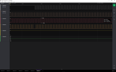

My task right now is to route ExtOsc to CLKOUT that I have done but for some reason I am being experienced  with strange behavior of I2C on flexcomm 2.
When I commented CLKOUT routing I got correct I2C communication.
 For more details look at the attachment to this post.
P.s. Channel 2 is CLKOUT signal.

Good morning.
I would like to share with you new finding related to the issue.
Mystery has been discovered and root course of the issue is misfunctioning of logical analyzer and results on the screen.
