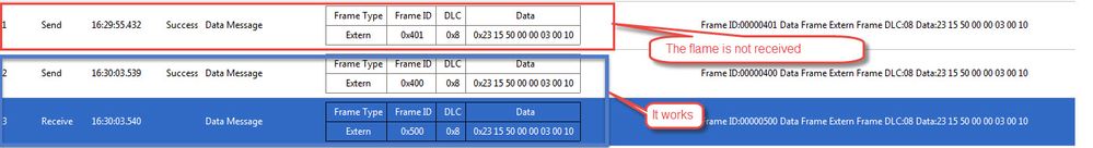

You can use the following code instead of the original code to receive the frame whose identifier is 0x400.
     msg_obj.msgobj = 1;
     msg_obj.mode_id = 0x400;
     //msg_obj.mask = 0x700;
        msg_obj.mask = 0x7FF;
     LPC_CCAN_API->config_rxmsgobj(&msg_obj);‍‍‍‍‍
And the Figure 1 exemplifies the testing results.
2017-05-02_14-02-43.jpgFig 1
