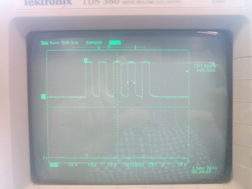

marinb
Hi Jeremy,
sorry for the delay, I made some screenshots of the oscilloscope output and also here is the table describing the behavior in the screenshots.
In the screenshots I always set number of pulses to 5. First screenshot shows burst sequence after previous burst sequence with DC 1% - 99% already ran. In this case number of pulses is correct = 5.
Second screenshot shows burst output when previous sequence was at 100%. In this case first two pulses are merged, so output is 1 wide + 3 narrow (normal) pulses.
Third screenshot shows burst output when previous sequence was at 0% (on scope this would be continuous low signal). In this case first pulse is skipped and only 4 pulses are output.
Fourth screenshot shows output at 100% duty cycle just for reference. I didn't attach 0% sequence since as I mentioned it's a continuous low signal.
I tried using the PWM_MatchUpdate() from PWM driver source you attached but unfortunately the result was still the same.
Previous duty cycleCurrent duty cycleNumber of pulses setNumber of pulses output
0%50%54
1% - 99%50%55
100%50%5(1) + 3
