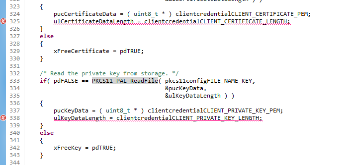

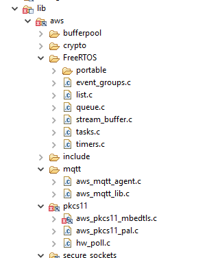

When we are building aws_demos project for LPC54018 on MCUXpresso IDE, which is directly downloaded from Amazon FreeRTOS website, it is saying that there are two undeclared variables in the library file. We followed the get-started procedure step by step, and set up all certificate things as required. The wired thing is that we think we should not change the code in the library folder. The website we followed is: Getting Started with the NXP LPC54018 IoT Module - Amazon FreeRTOS
Thanks.

Hello HAIYING JIANG,
We made a step by step guide with screenshots that explains how to run a demo project for the LPC54018 IoT Module. Please follow this guide from beginning to end. The tutorial is really detailed and everything works fine.
Link to the tutorial.
Hope it helps!
Victor.
