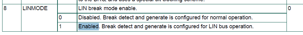

Another question, what the LINMODE in CFG does?
When I set this:
LIN1_USART->CFG |=  (1 << USART_CFG_LINMODE_SHIFT);
then the break generation doesnt work, otherwise yes.

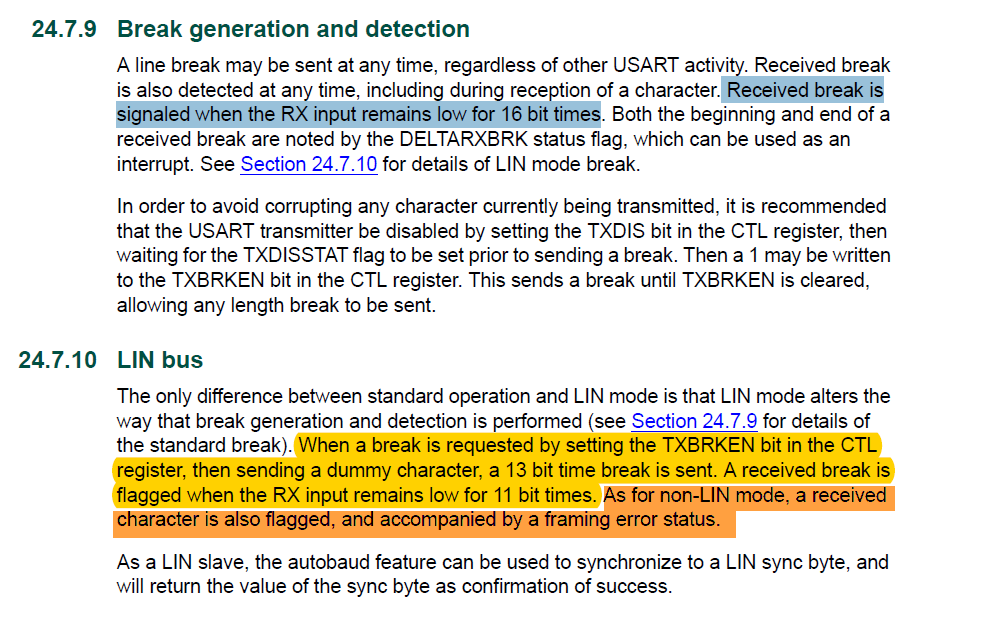

2. what the LINMODE in CFG does?
  This is the LIN break mode enable, the register already give the description.
If you use the LIN bus, you need to set this bit to enable the LIN bus break detect function. Otherwise, the UART is the normal UART break function, not the LIN break function.
About the difference between the normal break and the LIN break, please check these description:
  When you enable the LINMODE, after RX input remains low for 11 bit times, you will get the break state,and the received data is not stored in teh receive data buffer,  buf if you are using the normal operation, you will also receive the character, and the framing error status.
You can check it on your side.

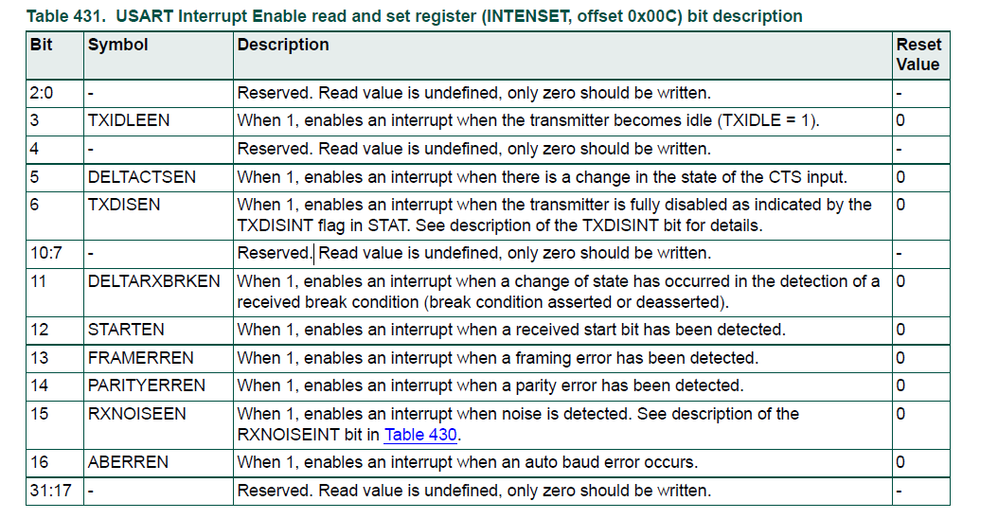

I use a normal opration and enable framerro IRQ  but when I received a frame data the frameerro flag can't set 1 and it can't go to usart IRQ!
                                                                                                        thank you!

Dear Kerry,
I still have a problem. When I set
LIN1_USART->CFG |=  USART_CFG_LINMODE(1);
LIN1_USART->INTENSET |= USART_INTENSET_DELTARXBRKEN(1);
EnableIRQ(DEMO_USART_IRQn);
Then the interrupt never appear. I think that the problem is with all INTENSET interrupts. When I set the FIFOINTENSET then the interrupt works.
Could you please help me how to set correctly the interrupt?

   // USART_EnableInterrupts(DEMO_USART, kUSART_RxLevelInterruptEnable | kUSART_RxErrorInterruptEnable);
    //kerry add
    DEMO_USART->INTENSET |= USART_INTENSET_DELTARXBRKEN_MASK; //enables an interrupt when a change of state has occurred in the detection of a
received break condition (break condition asserted or deasserted).

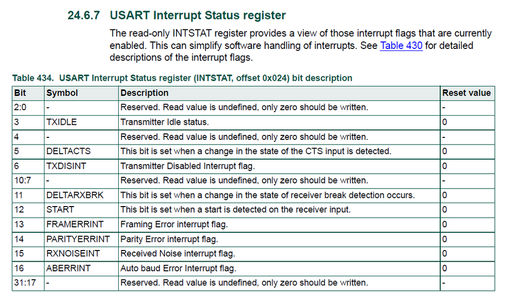

jan92
I have one more question:
how do I clear the DELTARXBRK interrupt? Interrupt status register is read only. Since once the break is detected then I allways receiving the interrupt even if the LIN is disconnected.
Jan

kerryzhou
Hi Jan Hakl,
    Please check the user manual at first:
So, if you want to clear it , just write 1 to this bit.

Now, talk my thought at first:
  After you run:
LIN1_USART->CTL |= 1 << USART_CTL_TXBRKEN_SHIFT;
Do you test the TX pin or the LIN bus? Whether the break is generated? Please take care:
TXBRKEN: value 1, Continuous break. Continuous break is sent immediately when this bit is set, and
remains until this bit is cleared.
A break may be sent without danger of corrupting any currently transmitting character if the transmitter is first disabled (TXDIS in CTL is set) and then waiting for the transmitter to be disabled (TXDISINT in STAT = 1) before writing 1 to
TXBRKEN.
As a LIN master, when you want to send the data, you Call the break send code, then disable it, send the data, this is master send process.
You said: I never get the interrupt that the break was detected
 Do you mean, you connect your RX back to your TX? Just use your own UART module RX to detect the break? Please also tell me how you connect in the hardware? Just connect the RX to TX?
Kerry

  if(DEMO_USART->STAT & USART_INTENSET_DELTARXBRKEN_MASK) // detect LIN break
       DEMO_USART->STAT |= USART_INTENSET_DELTARXBRKEN_MASK;// clear the bit

       DEMO_USART->CTL |= USART_CTL_TXBRKEN_MASK;//enable TX break;
       while (kUSART_TxFifoNotFullFlag & USART_GetStatusFlags(DEMO_USART))
            USART_WriteByte(DEMO_USART, 0Xff);//dummy byte, no means
            break;  //just send one byte, otherwise, will send 16 bytes
       for(i=0;i<10000;i++); // delay for the break generation.
       DEMO_USART->CTL &= ~(USART_CTL_TXBRKEN_MASK); //disable TX break

    DEMO_USART->INTENSET |= USART_INTENSET_DELTARXBRKEN_MASK; //USART_INTENSET_STARTEN_MASK |

   Ok, so the problem is still the if problem, if you use the polling, you need to use the while to check the flag.
Otherwise, you can use the interrupt.
