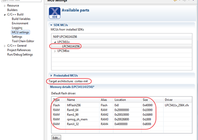

memory allocation is defined in "MCU settings" of each slave and master project,  for example
please note, you need build slave project first then build master project. master will link slave code. when download master code to flash, slave code will be download to flash as well.
