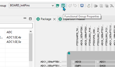

Just my 1 cent on this:
to my understanding, it calls board specific things like LEDs/Sensors only if the SDK/Config tools knows it is a board with known components. If you use just a device or chip without SDK for a specific board, it won't call things like initializing the LEDs, because it is unknown if they exist.
Instead manually calling it, you have to enable it here:
I hope this helps,
Erich

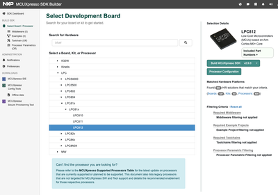

3,505件の閲覧回数
aaronm
Hey, Pavel, I'm not using a development board: I'm using an individual chip.  And for that particular chip, here's the SDK builder page, which it shows stops at v2.9.0.  Am I missing something?  Thanks, Aaron

ErichStyger
Specialist I
I hope this helps,
Erich
3,483件の閲覧回数
aaronm
Oh!  That's new to me, but that's just the thing.  Thanks, Erich!
