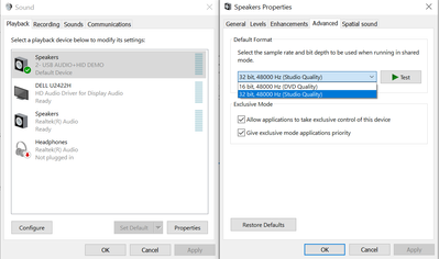

In order to change how many bits you are using you just need to modify the format of the speaker directly on windows.
This code was made to have 2 modes 16 bits and 32 bits, if you want to use 24 bits you will need to make the pertinent changes in order to do so since there is no other Application Note with that specific requirement.
Also, when I test it with the USB port of my computer, I was only able to use the 16 bits format, I needed to use a USB type C with an adapter in order to be able to use the 32 bits format, this may not be your case but is important make sure that the USBs are not a limitation as it was in my case.
