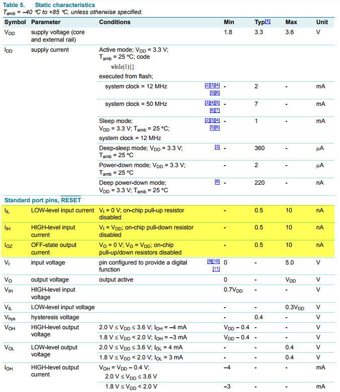

Just so I am clear, 10nA is the maximum input current on a digital input with input voltages of VCC, 0V, or VCC/2 ?
MikeN
1,890 Views
soledad
Please check the following values from the datasheet.
