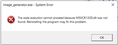

KrishnaNair_007
Dll file missing
4,024件の閲覧回数
KrishnaNair_007
Downloaded MSVCR120D.dll file and tried to execute, above error message popped

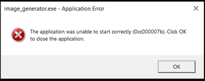

KrishnaNair_007
Response is same with the error as below (command line)
