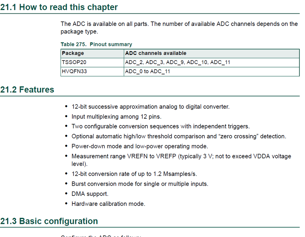

 i am using lpc824  in IDE adc header file having only for adc0 address only i need all channels address. i searched but didn't got plz let me know the address of all channels address  plz find my  below attachment of ADC0 address
4,042 Views
carstengroen
Senior Contributor II

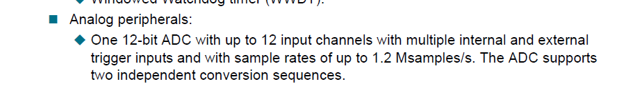

You need to read the documentation. This is not how the ADC works. There is 1 ADC converter, ADC0.
This has a number of inputs that can be selected
Datasheet:
Users Guide:

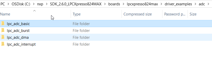

You can use MCUXpresso SDK and use the ADC examples as reference.
You can download it from the next link:
https://mcuxpresso.nxp.com/en/welcome
Sol
