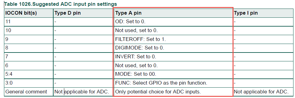

Please set the PIO2_0 pin as the red box highlights before initializing the ADC.
So give a try.
TIC

prasannanaik
Hi Jeremy,
   I tried the suggested point but still it is not working.
I have added the following code after adc_configuration()
IOCON_PinMuxSet(IOCON,2,0,IOCON_FUNC0|IOCON_MODE_INACT|IOCON_ANALOG_EN|IOCON_INPFILT_OFF);
I have connected the ADC channel 7 to gnd(i.e shorted Pin 7 of J11 connector and pin 7 of connector J9) but i am getting ADC output as =~4060.
I think it's some sort of pin configuration issue,please help.
Thanks and best regards,
Prasanna

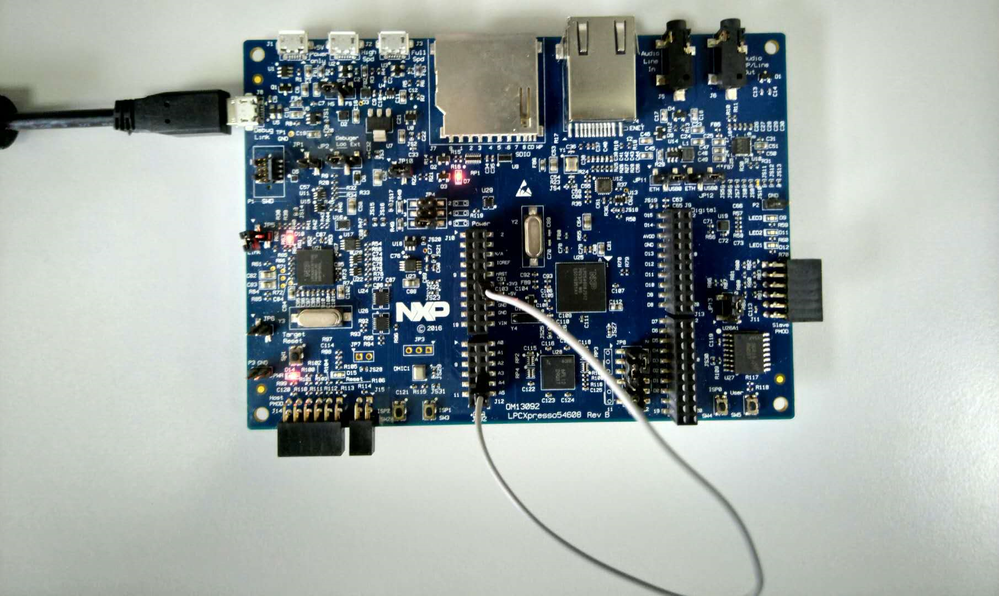

jeremyzhou
Hi Prasanna Naik,
Thanks for your reply.
In the lpc_adc_interrupt demo, I've added below codes in the BOARD_InitPins(), meanwhile, set the macro DEMO_ADC_SAMPLE_CHANNEL_NUMBER to 7.
Then, run the demo code, as Fig 1 shows, the demo works well.

prasannanaik
Hi jeremyzhou,
   I have following two queries:
   1) Which code have you added apart from "macro DEMO_ADC_SAMPLE_CHANNEL_NUMBER to 7"
   2) What have you shorted through that jumper in your attached image.
Prasanna

prasannanaik
Hi Jeremy,
   Thanks for your help.
   I was on leave so couldn't reply to your feedback.
   The actual problem was in connection of input signal. I didn't have schematic of the development board so i was connecting the signal to the wrong pin. The image of your board that u had attached triggered that thought.
Prasanna
