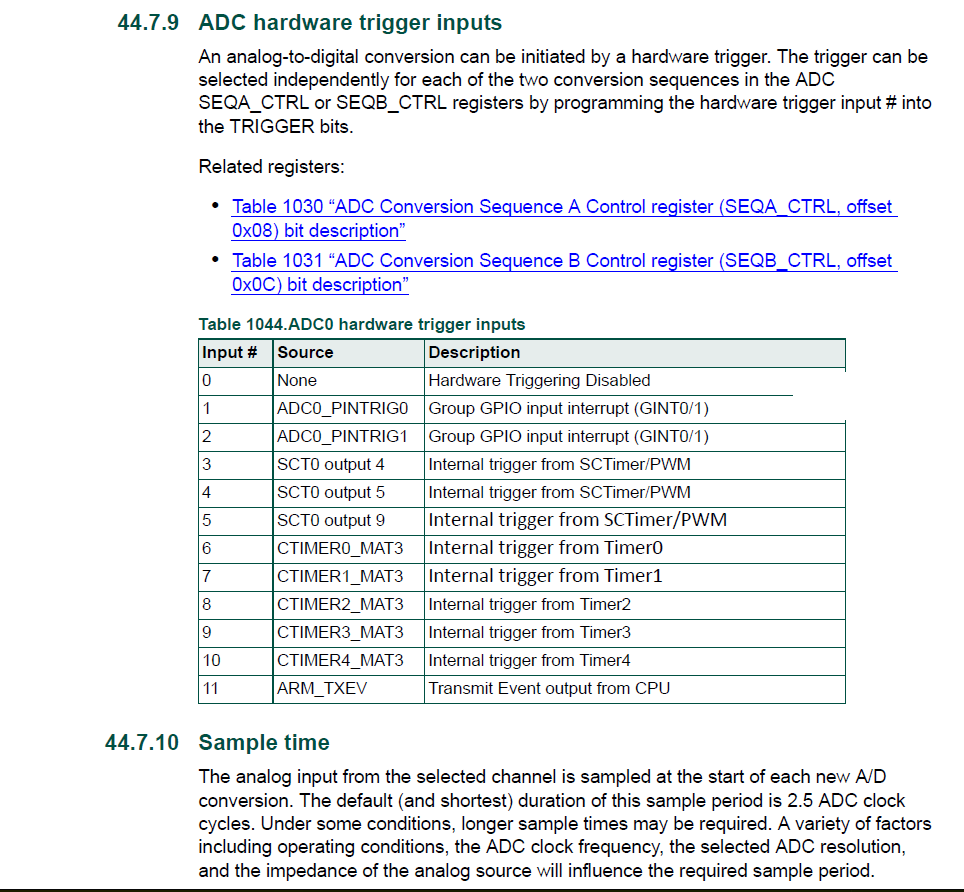

The ADC supports external pin trigger, pls refer to the following section. For the GINT0/1 module, pls refer to the section:
Chapter 14: LPC546xx Group GPIO input interrupt (GINT0/1)

Hi XiangJun,
   I need calrity on the feature that provides interrupt after completion of the sampling of all the cahnnels in the sequence.
   The manual provides details about only single select and burst mode which are not applicable to my application. I want to know the feature that provides this sampling of all channels on 1 trigger and gives an interrupt after completion of sequence.
Prasanna
2,375 次查看
xiangjun_rong
Hi, Prasanna,
You require  the feature that provides interrupt after completion of the sampling of all the cahnnels in the sequence with ONE trigger, okay, this is the bit configuration in SEQA_CTRL/SEQB_CTRL
BURST bit: 0
SINGLESTEP bit: 0
MODE bit: 1
Hope it can help you
XiangJun Rong
